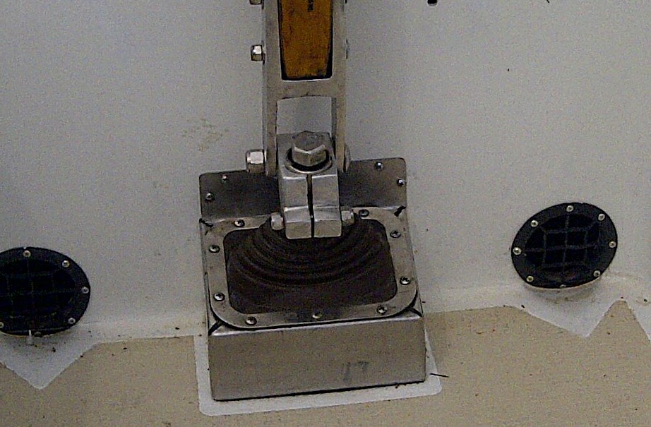

Finishing up the top section

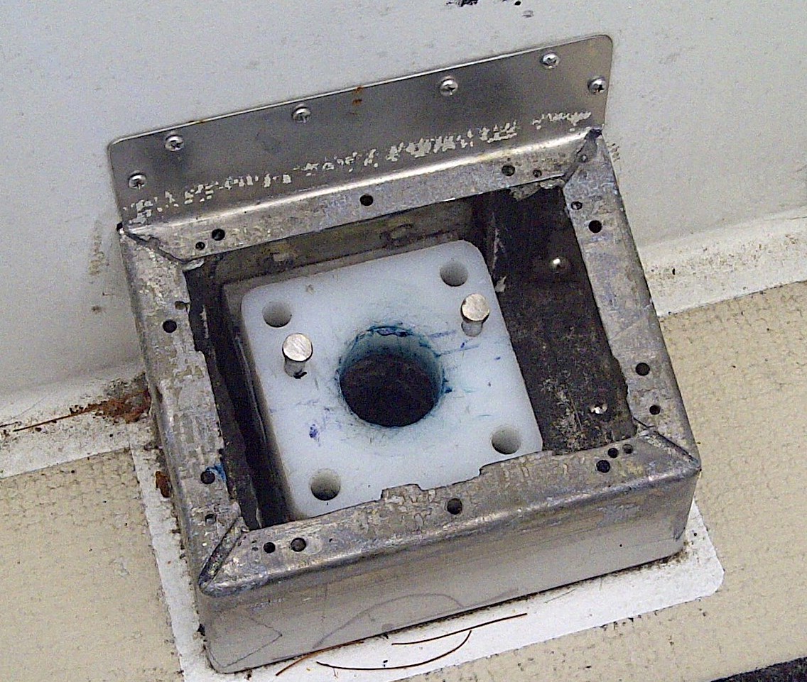

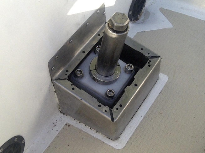

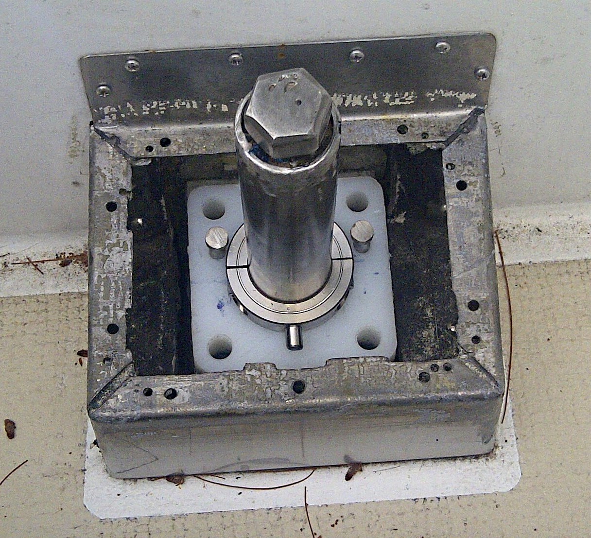

I built a stainless steel box enclosure for the top bearing assy. The UHMW block has two stainless pins to act as stops. Rudder is limited to about 200 degrees of movement. Added SS locking collar
Finished it off with a top plastic cap,..same UHMW material (some machining required underside for collar,etc.). Bolted it down and added a backup locking collar. The cap is also important for making sure the rudder post stays in position vertically. (keeps rudder from being pushed up too.)
Here's the finished product showing the rubber boot cover and tiller attached...
