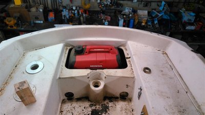

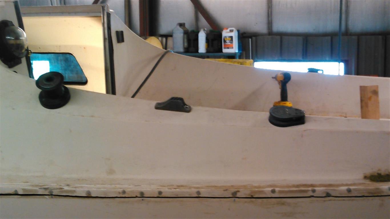

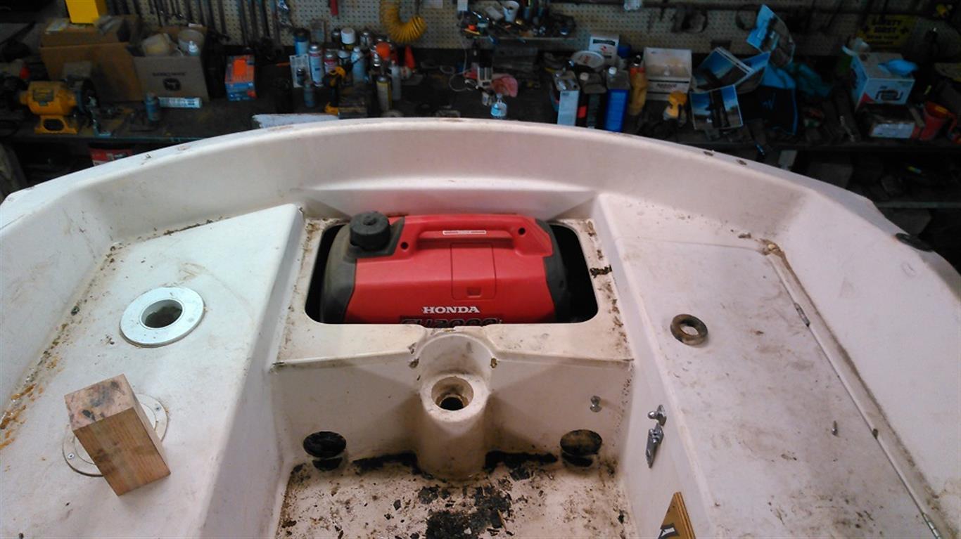

I'm pretty sure it is plywood. I took off my stanchions and had to route some of it out. The hull to deck is not very good but not any worse than most production boats. It has screws hull to deck then the railing and that also is screwed hull to deck. What I did was went inside and used some plywood strips and screwed through everything. The reason they leak is because the rail is supposed to drain but over time it gets clogged up. These boats are well above most boats. You will not be disappointed with it. It is a joy to sail. My advice would be to remove the lifelines and stanchions really everything pulpits and all. I removed the engine well also and glassed it over. The rails are easy to remove reseal and replace. Get some help and replace with bolts and nuts rather than screws. I am going to modify my chainplates this year and just go alongside the hull exterior. Get rid of anything attached to the deck. the windows are of some concern. They have a cardboard type of corrugated material. Remove everything, route it out about 1" deep, then fill it in with fiberglass or epoxy. then butyl and screw plexiglas right to the hull using oversized holes in the plexiglas.
