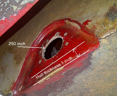

Chris,
The keel trunk is basically a plywood box that has been glassed and gelcoated for waterproofing. It does not actually support the keel entirely. It just forms a box for where the keel can retract into. Look for yourself how the keel is mounted. Notice that the bracket that holds the 900 lb. keel is actually fastened to fiberglass that is formed as part of the hull. Here's a previous post of mine where we discussed
http://www.chryslersailors.com/discussi ... highlight=
The fiberglass at that half moon cutout area is about a 1/4" thick. The underlying hull at that area is about an inch think.
It's the fiberglass that's holding your keel in the boat, NOT the plywood box!!
Having said that, the plywood box does provide structural shape and some support of the keel weight. You need it to be sound. So, in your case, is the rot in a small area? If so, you could be lucky and just cut out the wood completely there. If so, bolt a patch over the hole and seal. The patch material could be stainless steel plate, PVC plastic sheet, etc...Keep in mind the plywood is about 1/2" thick. I don't think you're looking at a huge repair cost.
Hope this helps

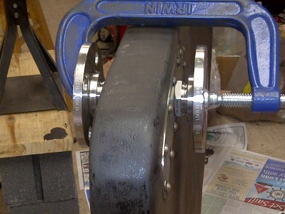

Chris,
Here's a link to a post showing the original keel stabilizer with plastic rod inserted. Plastic is either Nylon or UHMW PE or some other high density material. Best bang for the buck is UHMW PE, super strong and cheap.
viewtopic.php?t=4852
Most people on this forum don't put much stock in the effectiveness of this device. If only one one side, I tend to agree. That's why I modified my Chrysler with a port and starboard side stabilizer and used stainless rather than plastic. I think the stabilizer is a good idea if used like this.
