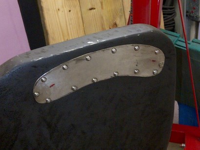

Finally got the keel installed. Been about a year since I posted Parts 1 and 2. As those of you know that have done it, it's not something you want to do that often, if ever again :)

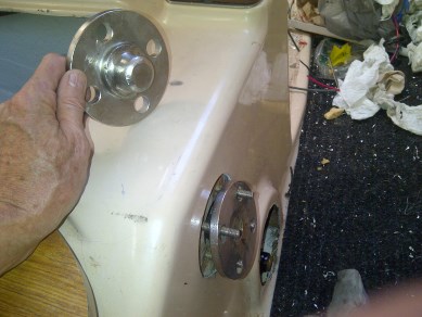

In Parts 1 and 2 I showed a design for what I'll call 'Keel Stabilizers'. Basically made a skid plate on both sides of keel and used some plumbing parts to form the stabilizers.
The later model C22s had such a stabilizer, but only on the port side. It was made from a galvanized plumbing flange with a pipe nipple and end cap. The nipple had a nylon rod inserted which pressed against the keel.
Here's the one I pulled from my 1980
http://www.chryslersailors.com/discussi ... =12&t=4852
I wanted to build something along the same design, but more robust. The parts are stainless steel and I installed with some tension on both sides. Honestly, I don't know how much it will really help. I suppose with an extremely worn keel pin it might help to stabilize the keel some. Would be interested in hearing comments.

Nice work Bob...let us know how it works out under sail.
