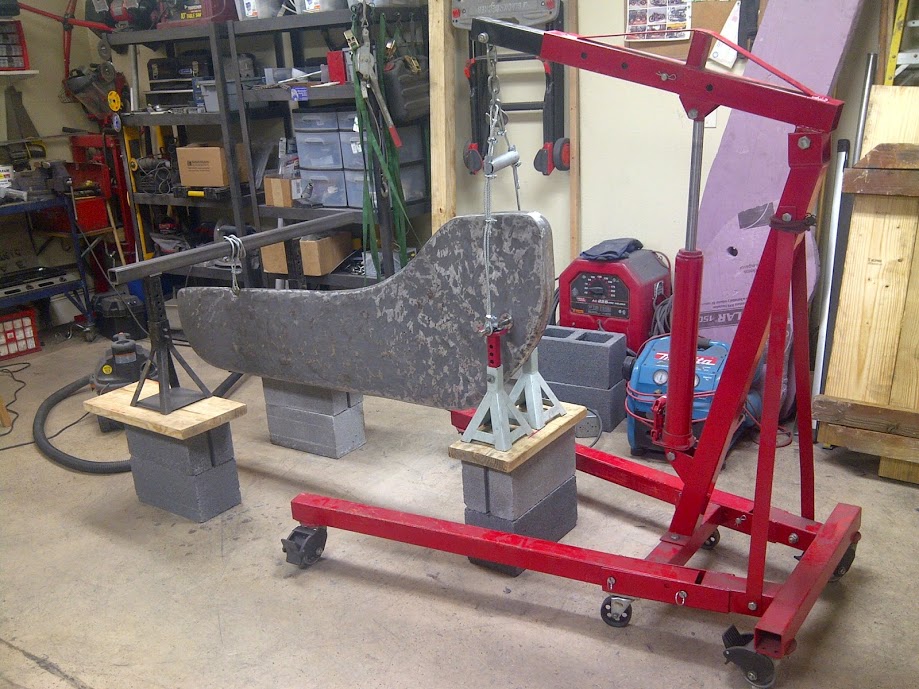

Wanted to share my keel restoration pix as I get ready to install her. As you can see, I had the usual deep pitting and scaring. Quite an ordeal with my power grinder using grinding wheels, cutoffs, and wire brushes.
Punched out the old sleeve and pressed in a new stainless steel sleeve with 3/4 inch bore for beefier support.
Also, capped it with flanges each side to support the sleeve ends.

The C22 keel is referred to as a 'shell casting'. It's cast iron over a stainless steel inner plate. A portion of the stainless plate is exposed where the lift cable attaches. My guess is that the inner SS plate extends the full length of the keel to include the sleeve/shaft area.
As for "...How did it get so pitted". My keel was badly rusted. Every layer I cut off with a grinder would show another layer, and so on..I was determined to get all of it. I used both 4.5" and 7" angle grinders with various attachments and as I like to say, 'I went medieval on its ass'
