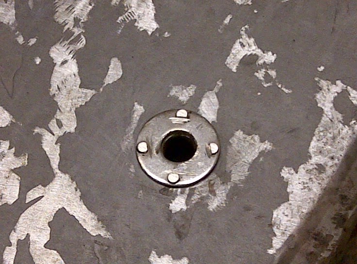

Wanted to share my keel restoration pix as I get ready to install her. As you can see, I had the usual deep pitting and scaring. Quite an ordeal with my power grinder using grinding wheels, cutoffs, and wire brushes.

Punched out the old sleeve and pressed in a new stainless steel sleeve with 3/4 inch bore for beefier support.
Also, capped it with flanges each side to support the sleeve ends.
