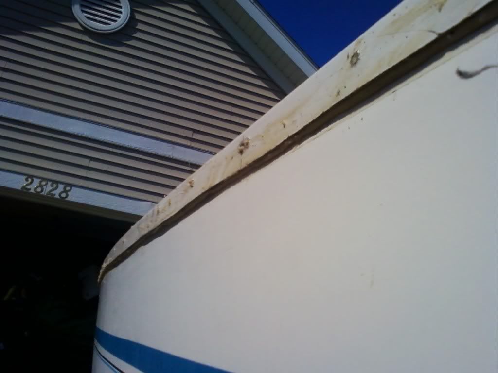

Well, we finally got some non-rain weather here, so I got a few jobs done on the boat. One big one was to seal the seam between hull and deck. I was getting water wicking up through there when the toe rail was in place. I decided to seal the seam at the fiberglass overlap and I'll likely do the same under the toerail.
The dilemma was in how to get the caulk up into the seam far enough to seal past the screw holes. Found an air driven grease gun on sale for $15. The gun shoots a metered amount of product with each pull of the trigger--very easy to control!

This nozzle easily pushed well up into the seam and the grease gun provided the rest of the work. As you can see, the caulk/adhesive fired well into the seam as evidenced by it's pushing out the screw holes as well.
