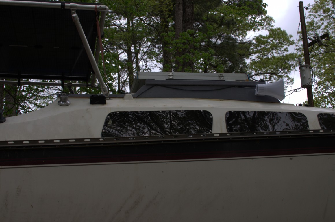

You should already have two to single hand the boat sailing. If you are talking about bringing the Halyards to the cockpit to raise and lower the sails this is where I put mine and is pretty standard on cruising boats. You need two standup blocks and a double deck organizer plus a double cam cleat.
