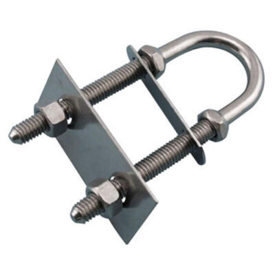

I have a Mutineer but it is up in WI and I will not be there for another month. A picture is worth a thousand words. If the bow eye is the one that you winch the boat onto the trailer it should have two nuts on the inside to tighten. If the bow eye is not the correct one and just a loop it may not tighten. You need one that has a plate so it will hold against the hull.

Thank you for your adivce Skipper Dan. I'll follow up on this stuff. I do have the two nut eye bolt and will try to get a photo poated, Bob

Here is one I found on Defender. They also make them with the top plate welded on, they look a bit nicer.

Thanks for the fitting info Skipper Dan. I believe the only way to tighten these fittings is to drill for a waterproof inspection cover onto the forward bulkhead or the cubby hole stroage area and use a socket at the end of a long extension. Maybe there's antoher way, but I can't come up with it. Thanks again, Bob
