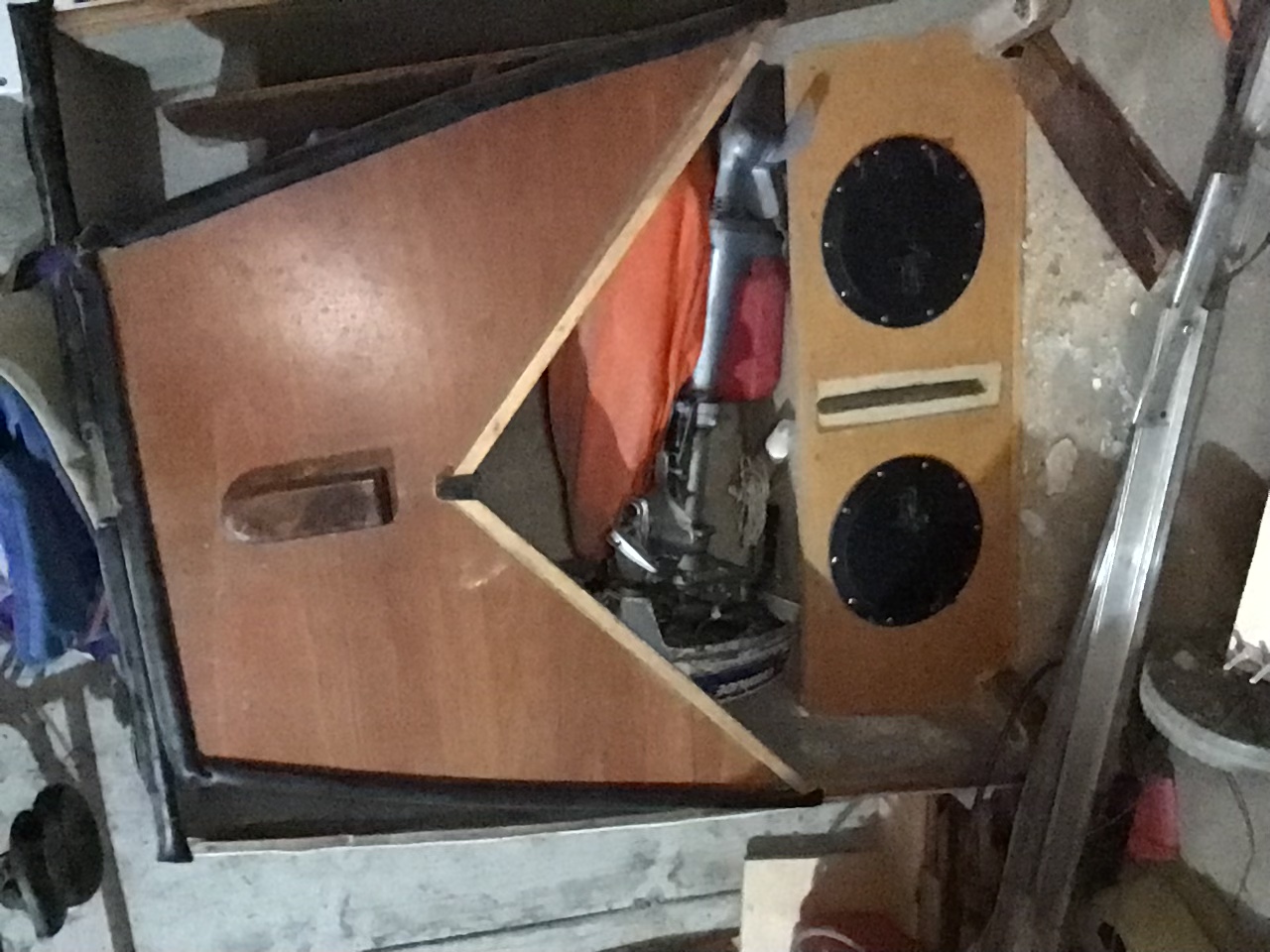

Quite a while back I bought a gutted Fiberglas dinghy to use with my C26 . It’s an 8’ optimist style with a center board and 16’ cat type triangular sail. I wanted to be able to store it on the deck of the 26 so I repaired the fore deck and gunnels , installed mating bulkeds at the middle with a seat boxed in and cut it in half to make a nesting dinghy. It’s been 2 years and I can’t find a way to get the construction pics off my old camera but here is a picture of it stored in my hanger in Sequim (I live in Co ) . I’ll try to get some pics of it assembled when I get up there in April. I have had it out with both the oars and sail. If sailing with such a tall rig one needs to be ready to swim. The two hatches in the seat are water tight and the seat is a sealed unit. There are two sealed bouncy tanks one in the bow and a small one in the stern. I haven’t checked to see how it does when flipped yet but will before sailing it in the sound. I also have a small 2 stroke 2 hp outboard I mount on the transom. What is everyone else up to ?
