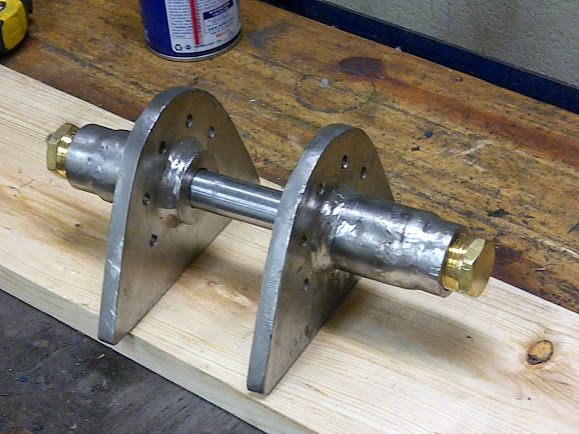

The Bracket
All Stainless Steel 304 parts sourced from McMaster-Carr
3/8" Plate
Pipe with 3/4" bore for main sleeve
Half-Coupling 3/4" NPT to hold the plug
Hardened 3/4" shaft
Brass 3/4" NPT plug
The welding is a bit crude, but will do the job. I'm not trying to win any welding awards :)
I changed my design slightly from some others I've seen here. I brought more (3/8") of the main sleeve out to the keel. The more sleeve steel there the better. The gap has to closed with something and using washers gives zero support. With this, I only have to close an 1/8" gap each side which I'll do with SS washers. Caveat - The keel can't be raised into the trunk in the full horizontal position since the keel sleeve area is 2" thick and the keel top is 2.5". Instead, raise the keel in the 60 degree position and then engage the shaft.

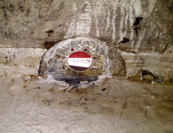

The Trunk
Here's the original. I don't understand why the half-moon cutout in the trunk wall.

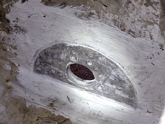

At any rate, I fashioned my own 1/4" aluminum plates to fill those sections.
Plates installed and sandwiched tight with Marine-TEx structural epoxy

great photos and great work. re the half moon shape, I'd speculate from my experience doing design engineering in the decade these boats were made that it's the common practice of using large radius edges wherever possible to minimize stress cracking of either the plate or the cutout. A square plate and square cutout is much more likely to experience a stress fracture with something as heavy as the rudder and the forces exerted by the water while sailing. Again, great work.
