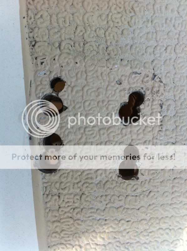

As part of the re-bedding project I discovered that the starboard shroud connection bracket holes drilled through the deck were huge and double drilled!

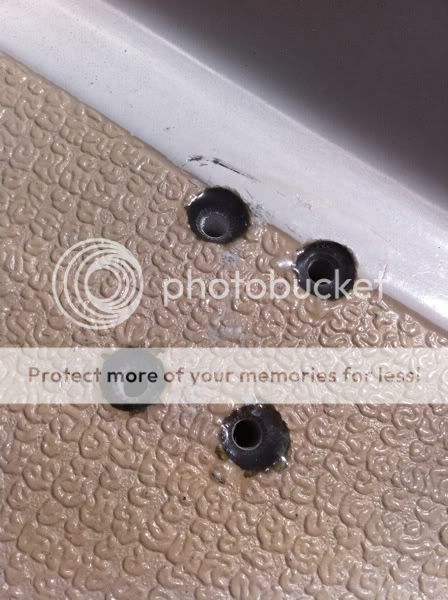

These were filled with epoxy after the holes were "cleaned" and then re-drilled.
Original holes, looks like an OEM production mistake! I'm glad I found this. The aluminum corrosion and pitting was incredible on the other side.

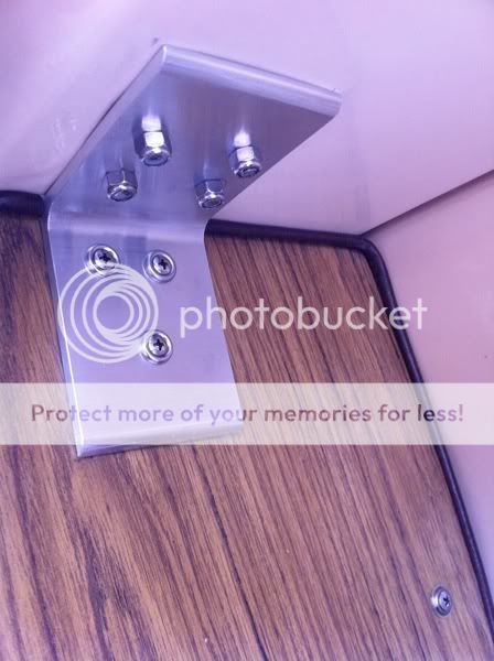

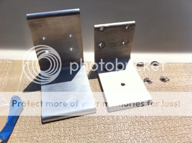

I also decided to replace the brackets. The new ones area 1/4" wider and now 4"x4" not 3"x4". I got the new ones from on on line metal shop for less than ten bucks ! I also ordered a set at 3"x4" but a bit wider like the original, I'm not going to use them so if anyone wants them PM me.
Installed :D
thats one off of the list!
