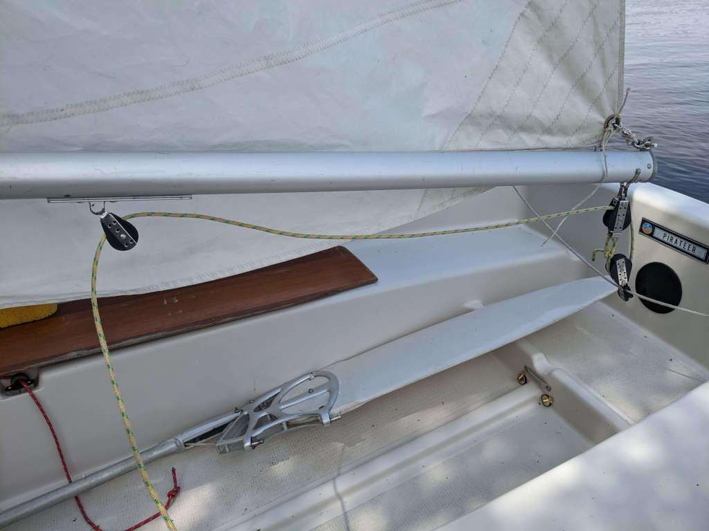

Mainsheet
My pirateer didn't come with a cam cleat on the boom block.
This is what the rigging looks like:
Tie the mainsheet off at the becket of the aft boom block w/ becket, down through the traveller block, back up to the aft boom block then to the fore boom block, tie off the end with a bowline loop.
Boom block, no cam cleat
