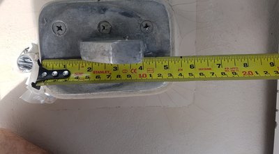

does anybody have a drawing of the mask step. Specifically the hook.
Re: Mast step measurement
I asked this question back in February and received no answer. While I was in the middle of manufacturing one from pictures, I ended up finding mind. I will work on a drawing for you next week. Right now my mast is on it.

I guess I was not using the correct terms. On top of the step is a cast plate with a hook on it. I was looking for measurement of the plate/hook.When I was lowering last year a cable hook broke and it came down hard and snap the hook part off and into the water.
I don't have that hook anymore, but it was probably 1/8" thick aluminum plate. Since that's gone, just rebuild
your mast step and install a new hinge plate. You'll need to make some changes to the mast of course but well worth it in long run
I added 4 pictures with measurements: https://photos.app.goo.gl/2qZyxPGsciWcuhyz7
