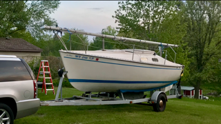

Bought this beauty almost 2 weeks ago. I've been really nervous about getting the mast up for the first time and going over all of the rigging. I was told by the seller that it is ready to sail, and from what I can tell with the mast laying down, everything seems to be there and in decent condition. I've read through the instructions on using the boom as a gin pole several times and think I have a good handle on it. Is there anything I should be worried about or looking out for? How tippy does it get on the way up? It has a mast hinge and bridals. I need this to go smoothly or I'll never convince the wife that this was a good purchase.

Nice looking boat and trailer. I'll let you know in 2 weeks when I try to raise mine for the first time on the C26 I bought this spring.
