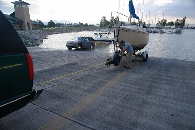

I'm adding couple more pics if it helps. The first is my old trailer, with boat. Second and third show final product. The keel is visible and you can see how it rests on rollers. Resting on the rollers, with my trailer, the bottom of the keel is probably very close to the same height as the side rails. This is the trailer that came with my C22, and is not the original Chrysler trailer. It's possible that some trailers may allow for the keel to drop a few more inches, but at some point you hit the trailer axle. I know you want to keep the boat as low as possible for launching. I can tell you that with my boat it's not possible to simply back into the water and expect the boat to float off. I always strap launch....another photo :)

Adding some strap launch pix I found online.

Wow thanks for the photos! Now I understand your trailers have little to do with the original Chrysler trailer.
I will be studying your photos, and coming up with my interpretations of the measurements.
Later, I will worry about strap launching...
