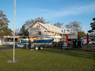

Can you post a picture of the trailer you have?
The reason I ask is I've had several different C22 trailers and they range greatly in height. Some sit the hull quite low as is my current trailer, while some have the hull quite a bit higher. Then someone with a similar trailer can give you a more acurate measurement.

I've pasted a link to a picture here. It is the factory Chrysler trailer that came with the boat, although I have added another axle.
http://1.bp.blogspot.com/-4-b2N5i-czU/T ... 11+003.jpg

Cool, she looks to be sitting pretty low on the trailer.
Just need a factory trailer with a boat on it now!
