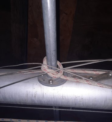

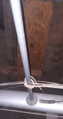

any one have a pic with measurments or know another Make that the mast spreaders might interchange with? The P/O installed some real nice pipe ones with a pipe 4 bolt flange.

Lucky you you have one of a kind custom spreaders! If you don’t like the custom look you can go to rig rite or a number of other marine suppliers. Just match the length and location with the replacements. You will want to make sure the mast is reinforced where the base of the spreaders rest on the mast.

Where would one find out how long, wide ,and placement of the the proper one would be ?

Looking through old posts I found one that indicated the spreaders should be about 28” He replaced the originals with some streamlined ones from Dwyer aluminum mast co. . 27-3/4” There is a picture of a set of original mast bases for the c22 that look a lot like the one in your post. Search the old posts , “ C22 spreader replacement “ there appear to be 11 or 12 posts. Click on the bold print heading to see the thread. The C22 spreaders are not the same as the C26. Your existing spreaders may be original. Good luck, let us know how it turns out.
Re: C22 mast spreader
Ok thanks for the info didn't see a bunch extra holes in the mast where something else had been mounted. Just didn't seem like a very Spam!!!!!!!! set up for a factory one when you see all those tapered tear drop type spreaders .
