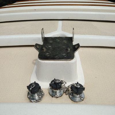

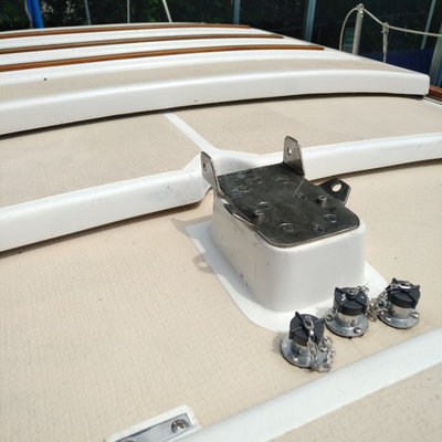

Not sure if these help. The only difference with mine is the SS hinge plate is my own design. The C22 originally came with an aluminum hook design that fit into the mast foot. I quickly got rid of that. Researching this forum you'll find out why. Several sad stories where the hook came disengaged....and well, not goodTBDay wrote:I have it off the trailer inside the shop so raising the mast is not possible. Checking the V birth and the seats for table inside against the water line mark are very close. Way the rigging looked and the mast step fiberglass broken badly repaired would not trust that part is even close. Looks like the back stay snapped at some point has some hardware store repair to it large turn buckle couple cable clamps.
I can get measurements if you need those. Basically though, the height of the step is the same fore and aft. Bubble level it (the boat) there and the boat is same as level in the water

Attach some pix when you can. File size is limited so post if you need help with that. There's a stickie post somewhere I wrote about resizing to fit, etc..TBDay wrote:Any help would be greatly appreciated
