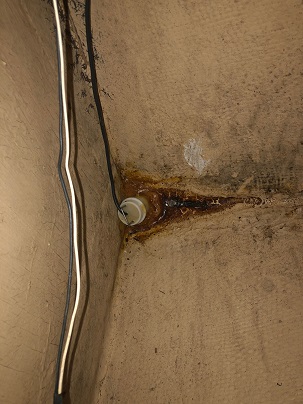

Thanks for the reply. I will try cleaning the lens. The transducer has been mounted in the forward hull center (not a good idea) from previous owner. Depth numbers are not consistent, random at best. If I can somehow release the transducer (heat gun?) I might try a new position shooting through the hull. Wish me luck getting that transducer out.

Just purchased a replacement transducer from SR Instruments. Nice they are still available

Glad you found a replacement, you might try checking your wiring , it looks like it’s been in there awhile, it might be a bad connection or worn insulation. Let us know how it goes.
