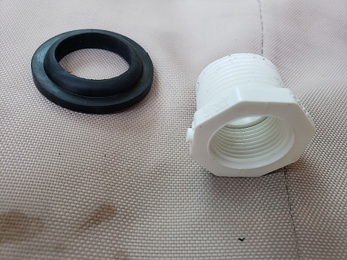

Ok, I'm not sure if even 3/4ths would have been large enough. Since the ends of the back stays are two prong, they don't fit down the middle. In any event, I think I measured where the holes in the bimini go correctly, but the backstays ends didn't fit through the grommets, so I had to remove the grommets. Then I used matches and melted the edges of the holes, then I put a small square of Gorilla tape on each side with an asterisk cut into the center so that I could fold each prong back of the tape to make the hole.
Next, I went to the hardware store and bought some 1" threaded plumbing pieces and some rubber gaskets that fit tightly around them and plugged the whole resulting in a hard plastic guide where the back stays go through.See pictures I may put some glue on to make sure they don't slip. They are pretty tight though.
When measuring, I found that I could not measure the side to side distance with the bimini in place, so instead, after I got home I measured the width of the bimini, found the center, and measured out 1/2 the distance between the stays, at the height I determined earlier in the process. That worked out well. I also put common sense clasps on one side of the bimini boot to close it, since the zipper would not go past the first back stay.
Since the boat ends a bit short of where I would want to attach the back strap. I put extensions on with some rectangular aluminum tubes I had kicking around. I may replace them with some ipe wood pieces if the aluminum proves not strong enough.
That is the end of this adventure.... I hope. I haven't been out sailing with it yet.
