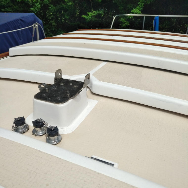

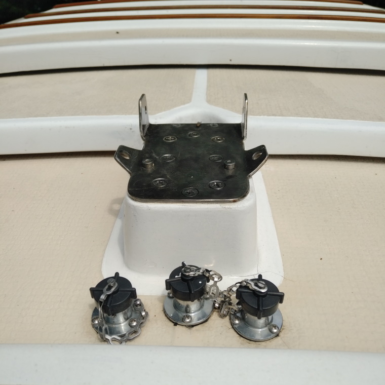

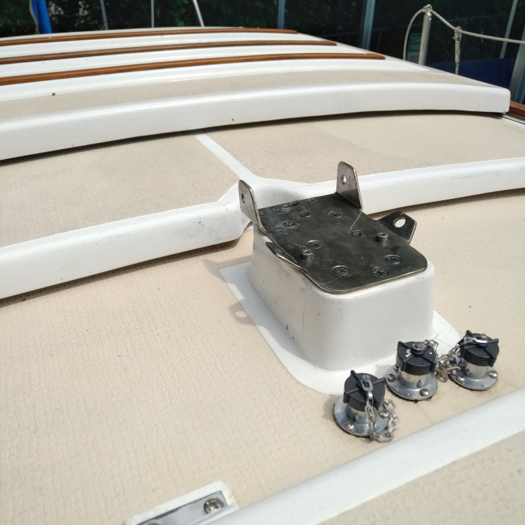

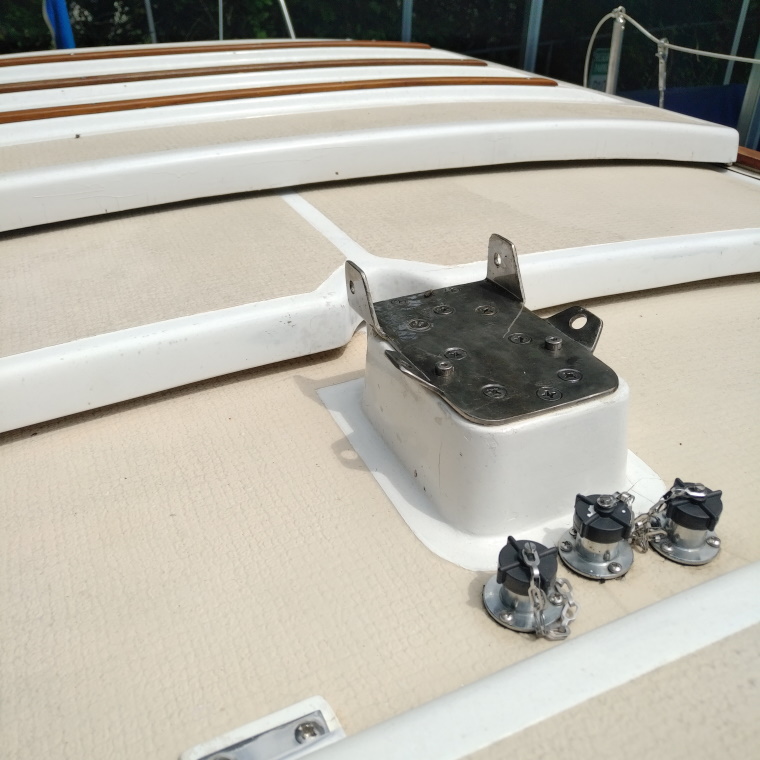

Not sure if these help. The only difference with mine is the SS hinge plate is my own design. The C22 originally came with an aluminum hook design that fit into the mast foot. I quickly got rid of that. Researching this forum you'll find out why. Several sad stories where the hook came disengaged....and well, not good :(
I can get measurements if you need those. Basically though, the height of the step is the same fore and aft. Bubble level it (the boat) there and the boat is same as level in the water
