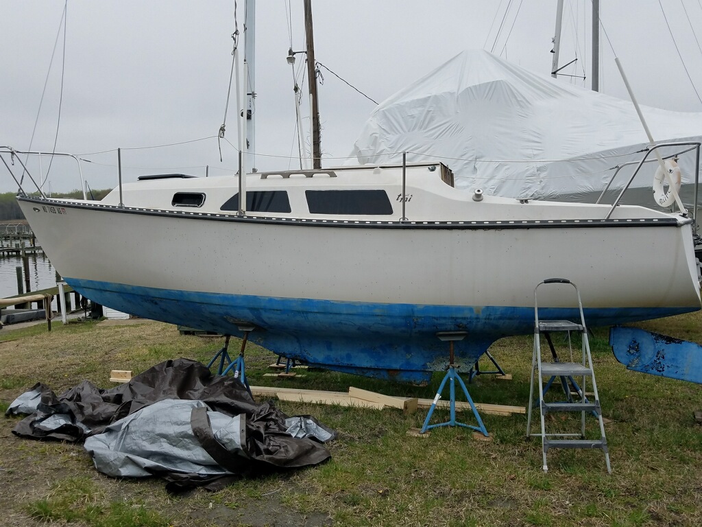

I'm planning steps to take for this hull. Blisters were treated by prior owner two years ago.
I'll wash the whole boat first, smooth sand the hull to ready it for a coat of ablative paint. If that sanding reveals any blisters, I'll treat those first.
You can see there are a few problem areas showing on the very bottom of the keel. They may have been previously treated, or are in need of attention now.
I’m also wondering what core/lamination methods were used on the Hull, Keel, Topsides, Deck ?
I’ve found a bit of exposed foam core inside the cabin area around the interior of the windows, needing a resin/fiberglass layer. I wonder if this foam material was used throughout the boat ?
As for the hull especially, was that also a foam/fiberglass laminate or wood/fiberglass ?
Was concrete used for ballast ?
Did they use epoxy resin? polyester resin ? Vinyl resin ? For any repairs, I'm thinking I will use epoxy resin.
Thank you for any insights.

Interesting boat, I see similarities to the C26. Rudder looks the same, keel also. Does it have a 2 piece iron shoe at the toe of the stub keel containing the pin for the swing keel? Ballast was a concrete/ lead buckshot mix on the C26. Is that damage at the rear of the fixed keel? C26 hull was not cored, cabin was cored with a phenolic resin saturated paper product by the looks of it. Other deck areas seem to just have plywood bonded to the skin then covered with a layer of glass - not truly cored construction. Definitely no foam in my '78!

I'm not sure about the 2 piece iron shoe, will have to look when I get back to her.
On the rear of the fixed keel, I'm not certain either. I'll check with the prior owner.
I wish I could post photos here, but the editor doesn't seem to allow it. Maybe the pink foam core I see around my windows was a prior repair. I'm not sure.
I'm sure enjoying learning and am eager to continue working on this.
