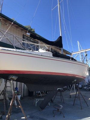

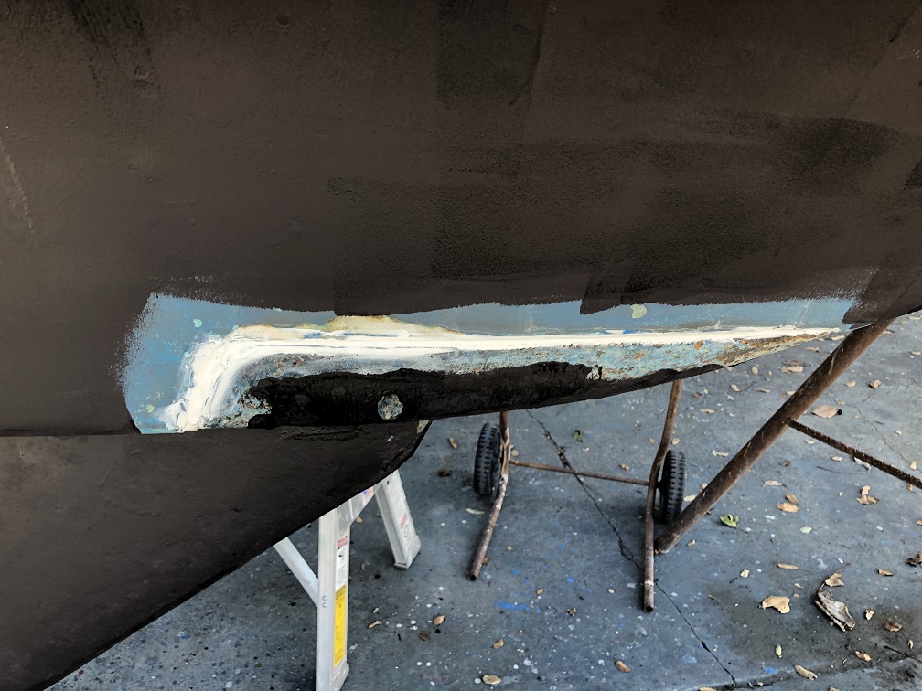

I've been chasing an odd leak. May have found the source while painting the bottom. Old caulking around the swing keel brackets.
While the boat was out for paint I took time to correct the float switch in the bilge so any water in the future should be expelled properly.

I may be mistaken but I don’t believe the area around the shoe gives any entry into the boat. The shoe is held on to the hull with bolts into nut type fasteners imbedded in the fiberglass . A possible place for leaks might be through various hull penetrations (through hulls ) or possibly the keel pennant.
Hope you find your elusive leak.

I agree with brigadoon, caulking there is fine for fairing but not likely to stop any water intrusion. Where does your water show up? Just in the bilge? Or is it appearing on the floor beside the keel trunk?

Thanks for the replies. It hasn't leaked at all since the bottom paint job and new caulking. The water would appear in the bilge and eventually spill over into the cabin area. Once there was several inches. I'll keep an eye on it.
