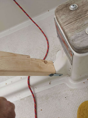

Template to mark holes:

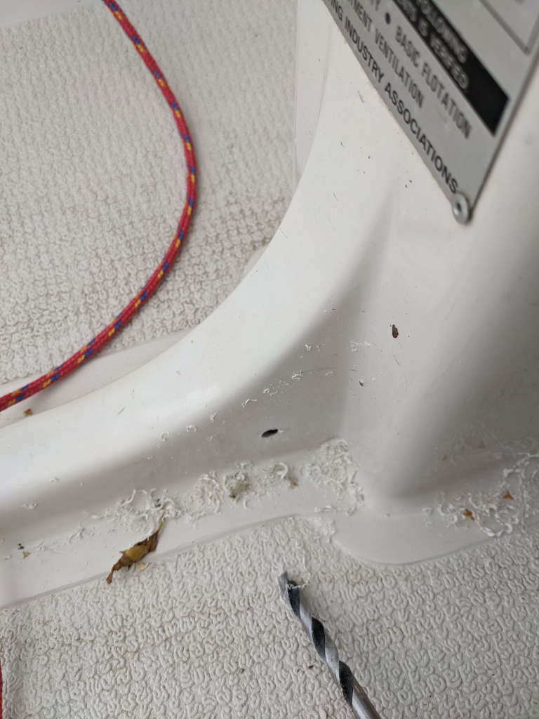

Drilled holes in my boat!!!

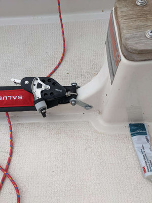

Small slit cut in hiking strap to feed block swivel
Galvanized steel bracket with a ton of silicone, and voila, deck block plus hiking strap

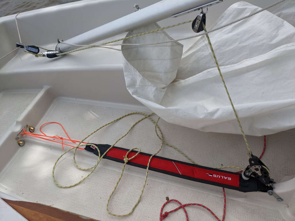

End result. (waiting for silicone to set so I can test it out).
